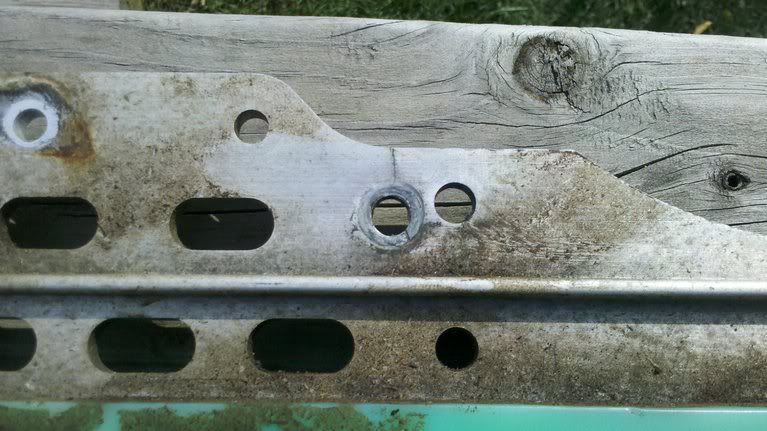

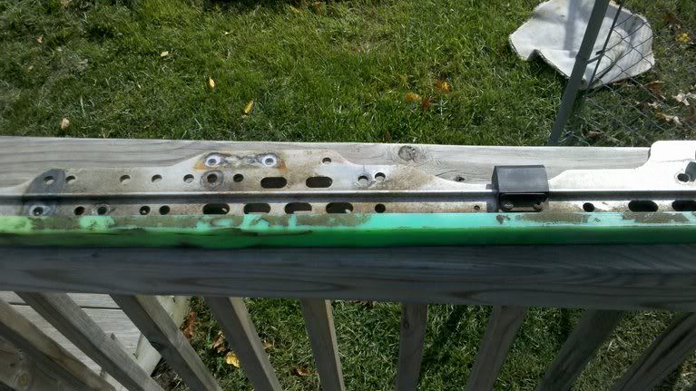

Today I get to show ya my latest snatch... 160$ for the below pic. 07 f1000 128 rails stretched to 136 .....
New hotness
Old and busted
Why I bought rails
So im mashin 98 arms on 07 128 rails:) already mocked it up and painted most of the parts ... next pic will be built s
Giggity

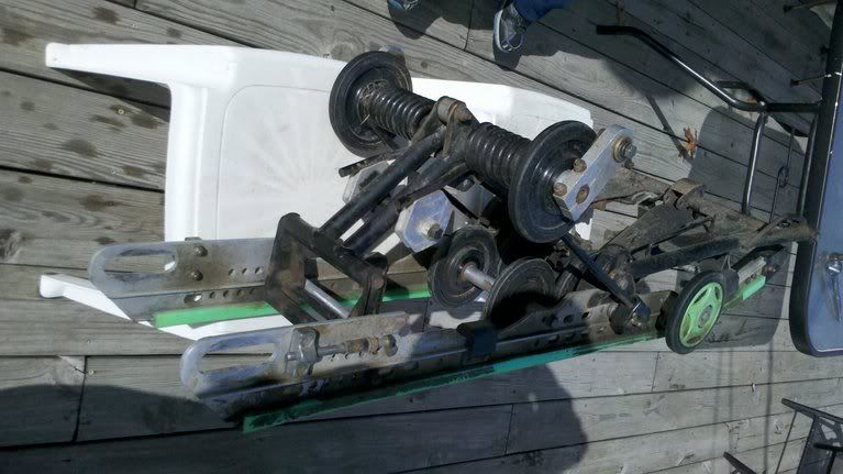

Welp I finished it today .... and if this isn't a indication of exactly where im goin with this slec appearance wise...... got vader?
U see I already located the bracket and drilled bolt holes made a cut line
Ear cut and bracket installed
Saddle vs/ tab
Test fit successful
All nuts/bots/cross shafts/spacers/brackes/wheels :) black
All done :)lol new hotness

2,363 Posts
Nice find. I think you rail tips are going to hit the drivers. Notice on your old skid how your front arm extends out past the tips and on the new skid they sit further back. Unless you are drilling new holes they wont.
is wielding a
7,578 Posts
Discussion Starter · #6 ·
I don't have the reference pics.... but the bracket on the 98 skid is near 3" farther back than these. What this is allowing me to do is use the lowest mount holes in the tunnel and have roughly the same track approach angle as if it we're tucked up in the tunnel ... if my measurins right.. and so far so goos ya know. ... rail tips are set back as if I used a 121 skid setback into a 128 track. Stay tuned to see what happens when it goes in the sled :bc: trust ill have your concern in the back of my mind tho.. but fwiw ... the front scissor rests on the the bumpstop dead center when fully collapsed

I just measured. 20 3/4" from rail tip to center of 1st bolt hole to w arm mont bracket on my old rails.
New rails are 18" measured at same places :)
