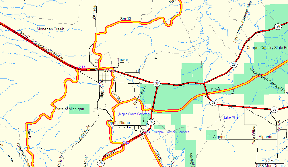

Personally, I think TOPO has too much clutter with the elevation profiles (luckily you can turn them off on some units).
The image below is the same area as Ross has shown on his GPS screen shot, just zoomed out a bit with a different map.
