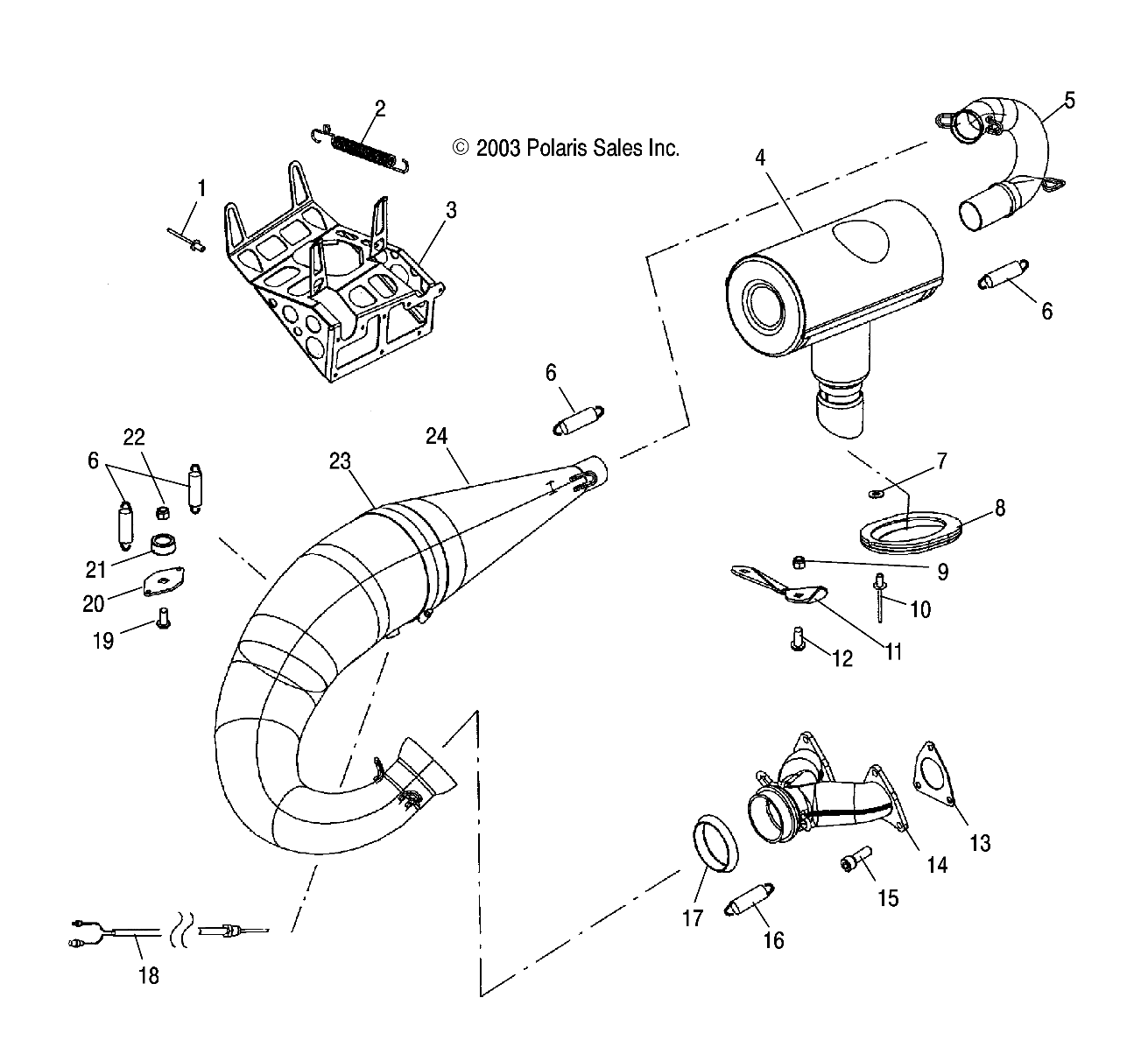

I have a 700 ves engine and I am in the process of installing an slp single pipe. The fit is kinda goofy like all slp as you have to reroute the coolant bottle. I also have to tim the hood and add heat reflecting tape. My concern is on the shock tower rubber mount. It is 1/2" away as the pipe rides on the 1/2" cross beam member that keeps the shock towers from spreading out.
The simple solution is to just remove the steel member. It doesn't seem like it serves much of a purpose for guys not jumping. I don't do a lot of jumping, mostly mountain riding. If I remove it, the pipe will sit down and I won't have to trim the hood.
Can i just cut it out?

The rubber bumper should hold it above the bar. You can add shims(washers) to increase the height above the bar. Check to make sure they sent the right pipe, y-pipe, & can they occasionaly make a mistake.

i can add shims to increase the height of the bumper but it would be a lot easier to just cut the bar off. Does it provide a significant benefit? The edge style chasis does not have one and I am guessing it is there for rigidity for the snowcross race applications.

If your cutting the bar off you might as well have ordered the pipe for a regular xc that way you won't have a dent in your pipe which gives less horsepower. Correct me if I'm wrong but the dent for the cross-bar is the only difference in the pipe and it prouced less horsepower.

That was more hearsay than anything. I think it was Hot Seat that started saying that (and even published it in a magazine tech article) so they could sell you a pipe with no dent for $500.

Polaris Nut is correct, the little dent means nothing and will not effect HP in any significant way. Being off 1/2 a jet size will have more effect on your HP than a small dent like this.
