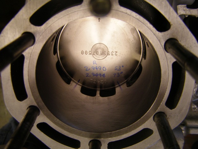

The 96 red heads are different from the 97 and 98 red heads. From the pictures I've seen the sparkplug seat area is even with the head nut seats like on the purple heads we have. The 861 Wiseco pistons have a step so the stock chambers don't have to be opened up. That reminds me of something interesting about the 35cc read head set I picked up - they were cut for a larger bore. So either they were on a stroker or a turbo machine, nothing else makes sense. Unless it was a low compression "top hat" mod? I can't find any info on that mod though.
Here's a shot of the piston in the bore, you can see the step that seems to be for chamber clearance;
I know there's too much side clearance on the primary clutch, plus I need to get the machine back to Polaris belts. 1065 seems to be a highly recomended one, I see others are too - 1075 is harder or something? Anyway I'm going to pick up the spider tool for the 4-Pro so I can science out the clutching.

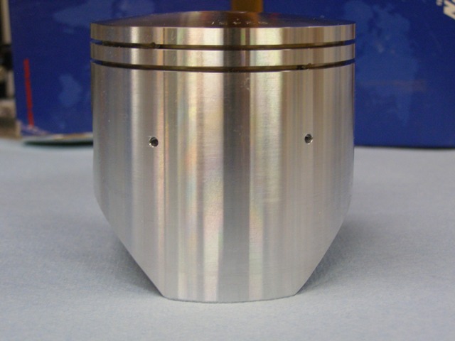

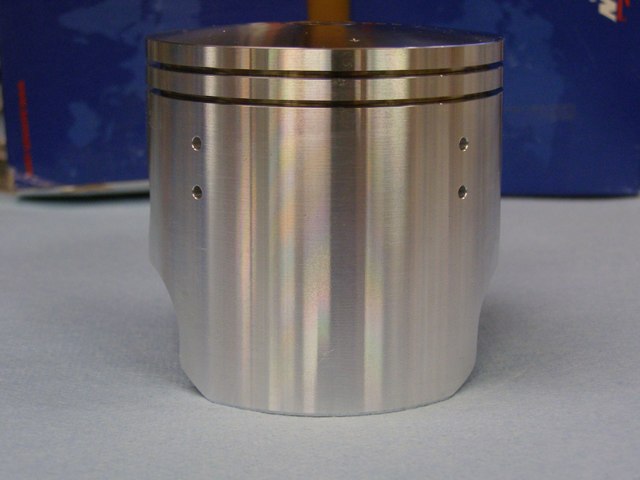

I thought long and hard about sleeving the cylinders, and using Wiseco pistons, but that part of the project turned out well. I set the piston to cyl wal clearance at .0060
Pistons modified to help prevent the "four corner sieze";
