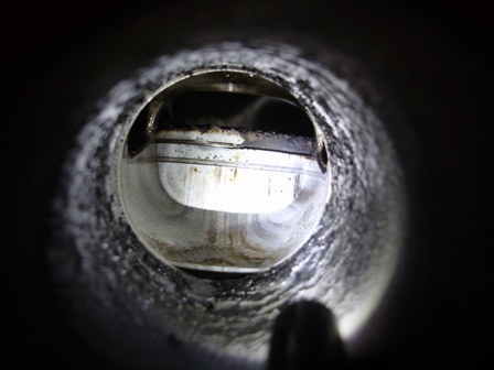

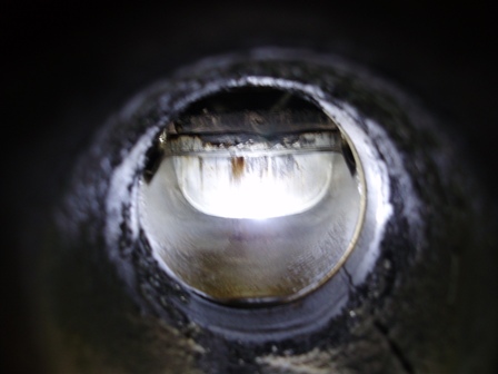

Thanks.
The 21/39 gears are quite a bit better but we pulled the pipes and looked in the exhaust ports, the top ring is broke and gone and the piston top eroded away on the exhaust side of the middle and right cylinders. So now I know what I need to do.

Middle cylinder;
Right (recoil side) cylinder;

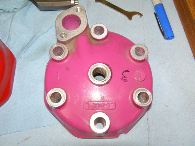

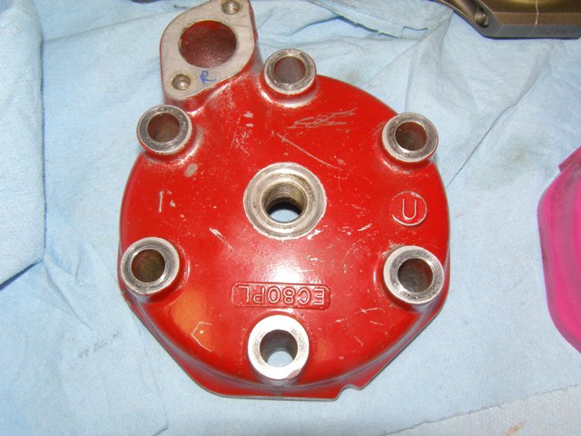

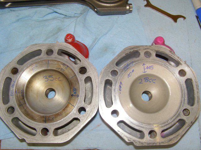

  • weird 1996-1998 red cylinder heads that are 35cc (stock are supposed to be 26cc)

Oh, the compression is about 95-100 on all cylinders - that's because of the 35cc chamber heads. I didn't know they were 35cc when I bought them - seller didn'tknow it either and has no idea what they were on.
35cc red head, 26cc purple heads, notice the spark plug height lower in red heads, red heads have a shallower chamber;

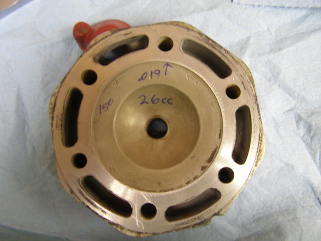

26cc stock red head;
